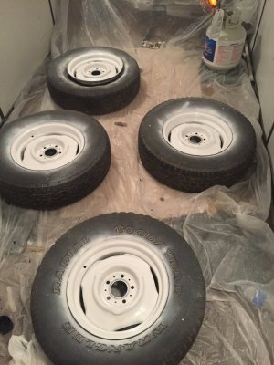

I got the control arm in without too much trouble. I cleaned up all the rims and painted those. I’m still unsure about the tires tho, I picked up as set of 31s with decent tread and need to mount those up and see if they fit.
