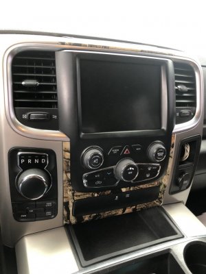

I’ve got an issue I was hoping y’all could help me with. Ive been in talks with Mpgrimm2 & he suggested that I post on here to see if y’all could see if we over looked anything.
I have a 2015 RAM 1500 & I’ve recently tried doing the 8.4 UConnect upgrade but the climate controls are not working.
Here is what I have:
**8.4 UConnect ra3 screen (pt# 68249986AH)
**Dual auto climate control bezel (pt# 1UJ97DX9AJ).
—originally I thought this piece was my issue so I purchased a singe zone manual bezel (pt# 1UJ96DX9AE)
**It came with a 7spd harness but everything about it looked wrong to me & the guy at 4th Gen RAM Electronics. So I purchased a new one from him.
—I thought this for sure was my issue since replacing the bezel didn’t help.
**HVAC control module (pt# P68268186AA).
—This is the only thing left to replace.
Everything works on the radio except the climate control. If I try one of the new bezels, the only thing that I can control is the volume/changing of the stations. It just says “climate control off” on the screen & there is an “on” button on the screen but it does nothing. So I’m having to use the stock bezel with 3 knobs that only controls the HVAC system & I can’t even adjust the volume of my radio, which makes my over an hour drive to work everyday pretty dull.
I’ve tried everything that I can think of to get it to work. I’ve used AlfaOBD & even unhooked the battery & touched the disconnected cables together just to see if maybe it needed to “re-learn”.
Needless to say, I’m at a little aggravated...
