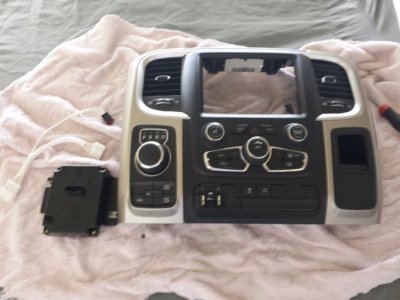

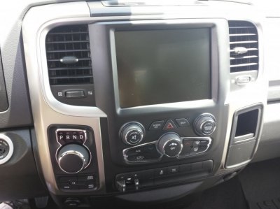

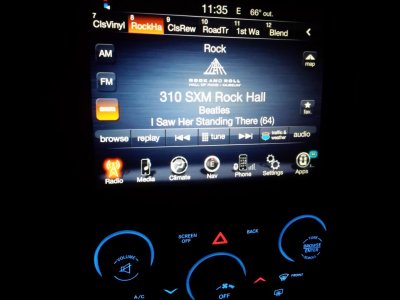

The O.E.M parts bezel is no comparison to the factory bezel and is way over priced. Trust everyone factory is the way to go and not much more if any than the OEM parts once you get all your pieces...you need the harness the module and the bezel total will be about 300.00 of your truck has a 7 speed fan.... compare this to there's
This is a bit picky , but , please read what you just posted and correct the ( detailed words ) for people that are not as familiar with the upgrade as you.are Sir ....
