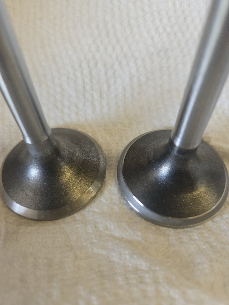

Question about valve lapping: I did cylinder 1 new valves, and noticed the finish on the mating surfaces of the valve and seat went from shiny to dull grey. Even, but dull.
Am I correct to (assume...lol) this is normal?
If I clean the valve and seat, oil and install the valve, I can spray brakleen in the port on top of the valves, and just by hand pressure on the stem, it does not leak past the seat, until I relieve pressure on the stem.
Want to make sure I'm ok before I screw up all 16 valves....lol.

That's pretty normal Ed,most valve lapping compounds leave a dull finish.

"That's pretty normal Ed,most valve lapping compounds leave a dull finish."
Thanks, Rick.
Kinda thought so, but wanted to be sure.
Seat:
New vs. new lapped:
