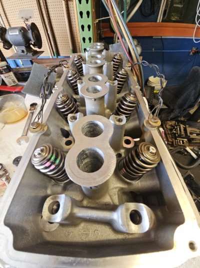

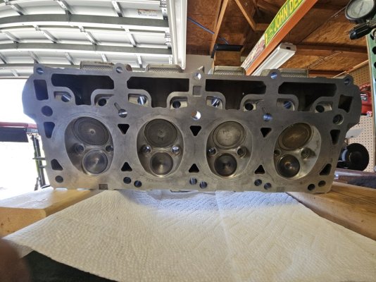

Finished lapping my valves, removed the phaser, and pulled the driver side oil galley pipe plug there was still some oil toward the rear. I did not see anything else in there, buildup, etc.
There was some sort of sealant on the plug, which I likely don't have. I believe its a tapered pipe plug.
Can I use some blue loctite, or do I need to go buy something else.
I'm gonna leave the passenger side galley plug alone, being that driver side was clear as far as I could tell.

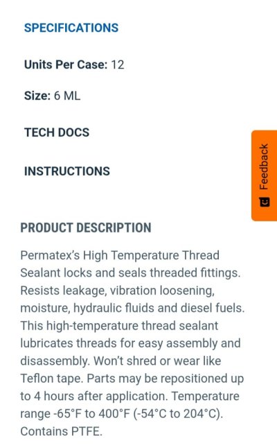

It'll probably work perfectly fine Ed.I use either ARP thread sealant or Loctite 592 thread sealant,neither one has ever let me down,but the Permatex brand is probably just as good.
Yea, I went on the Permatex website and looked at that stuff. Website says, "contains PTFE". I don't see it anywhere on the package, though.
View attachment 572841View attachment 572842
It'll be perfectly fine Ed,i wouldn't worry about it.It's probably virtually identical to either the Loctite or ARP versions of thread sealant.

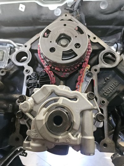

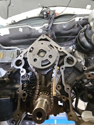

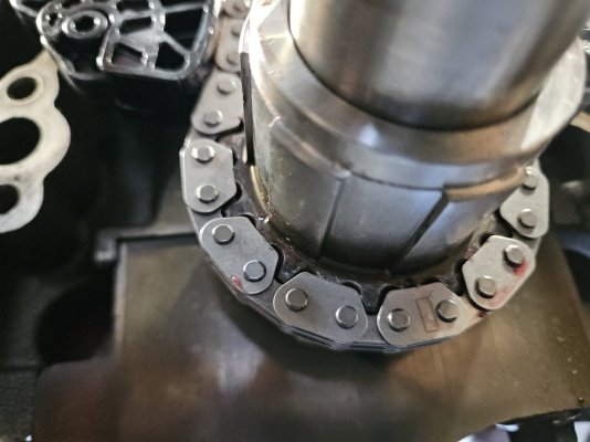

Went ahead and pulled the passener side oil galley plug. Looked same as driver side, some oil still in rear part of galley. Cleaned off the oil galley plugs, added thread sealer, torqued to 20 ft-lbs.

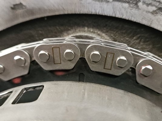

Installed the thrust plate, cam phaser + new bolt w/loctite, torqued to 90 ft-lbs. (My God, did it seem like it was never gonna click my FIL's Snap-on 1/2" drive 50-250 lb torque wrench)
Hope timing is set right:
Installed guide and tensioner, 8 ft-lbs this time....lol.
Gonna give the chain a coating of assembly lube, then install the oil pump.
