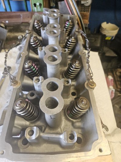

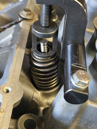

Driver side head is done. Just have to clean the sealing surface on both heads before install. 20250921_124754.jpg20250921_124818.jpg
One thing I didn't care for, was the cheap valve spring compressor tool I bought from Amazon. It worked but the angle was a little off on the arm.
I had to jockey the springs a bit to get them where the keepers would go on right.
Almost time to bleed and install the lifters.

About the 3 minute mark he uses the exact same C clamp valve spring compressor i have Ed.Mine is probably going on 40 years old now,but it still works good on most heads.
I'm now wondering if the arm is installed backwards on mine, will check tomorrow.
Gotta love the Chinese stuff.....lol
When I used my tool to remove the original springs, the keepers woud not release from the retainer and would just push the valve open.
I had to use a large c-clamp with the cage from the new one to get the keepers to release from the retainer.
Did you swat the valves with a dead blow hammer,before trying to remove the springs.retainers and keepers.They usually need a good swat to help unseat the keepers before you install your valve spring compressor.
Yes, but no dice on the hammer.
The c-clamp broke them loose pretty easy, I had to put the cage from the new compressor over the retainer and run the clamp screw against the bottom of the valve. It waa a little tricky, but not too bad.

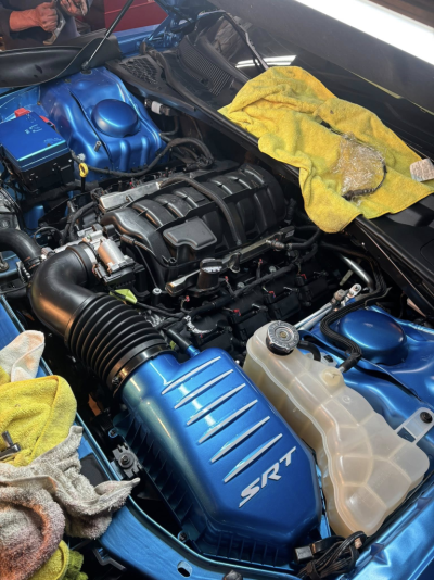

We finally got the headers late Monday afternoon Ed,we would of fired it up last night,but with open headers the neighbours would of probably strangled us at 10:00 on a Tuesday evening,lol.
Yes it's a 6.4 with my ported 5.7 intake,and it works better then his original ported 6.4 intake.Yea i don't follow the mainstream :waytogo: :Big Laugh:
This was late Monday evening,lol

I usually just use the socket and hammer method to pop the valve keepers loose. Re-installing them is always a pain. Keep up the good progress!

Thanks Ed. To hell with vehicles though,i feel for you on the dog,losing a dog that's been a family member for years hurts as bad as losing a family member.Take care Ed,thinking of you ;)

We got it all back together Ed,with no leaks,and it's had a couple tune revisions,so it's making the 155 mile trip to the track and going drag racing today,to see how much differance his cam and long tubes make :signs1:
He's hoping his 10 grand Canuck in mods takes a 1/2 sec or more off what it ran last time out,me i'll be happy if it takes 2 or 3/10's off:Big Laugh:

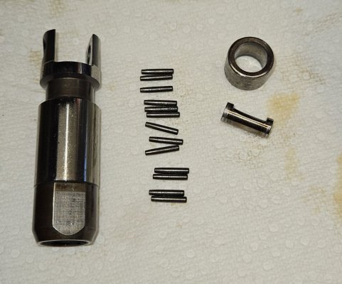

CHECK THIS OUT!!!
On a whim, I decided to dissect my bad lifter, #5 intake (non-MDS lifter) . Here is what I found when I removed the roller pin:
The pin itself failed and the needles ate away at it. Also, the needles are slightly tapered on the left, you can see the corresponding wear on the roller pin.
Here's how the roller pin was oriented when removed:
Additionally, at first, I could not depress the center of the lifter that the pushrod operates.
When I used my little bleeder pin tool on the check valve it was as if it were stuck, and then freed up. Not sure if that played a role in the demise of the lifter/cam, but.....????
If I ever make it through this repair, I may just dissect the rest, too. Especially both #8 lifters, because thats the other two cam lobes that were starting to fail.

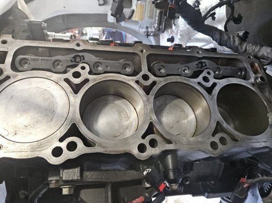

Ok, lifters are in and torqued. Block surfaces are clean. Heads can go on tomorrow morning.
Do I need to push each lifter forward in the tray so that it's roller can contact the corresponding cam lobe?
I figure it will happen anyway once the pushrods are in and the rocker arms are torqued down, but wasnt sure if I should do it before installing the heads, to remove the play.
Looking to see what the FSM has to say.
