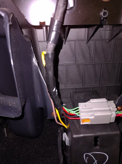

I just tackled a similar problem but for my AAWireless module (does the same as the Motorola). Mine would cause the radio to wake up partly if I was near the truck, I have a UAQ radio.
I pulled the panel at the back of the center console and put a small relay wired into +12V that goes to the media hub power.
It is the plug pictured here and it was the red wire in the #5 position ('15 truck)
Similar relay I used: Directed Electronics 8616 Relay Assembly Mini https://a.co/d/7GX3M1Y
I wired this to the power outlet in the try part of the center console as the one in the back I have the fuse set for constant power.
I can't take all the credit for this as @Mpgrimm2 helped with the idea and wiring diagram and he posted this:
