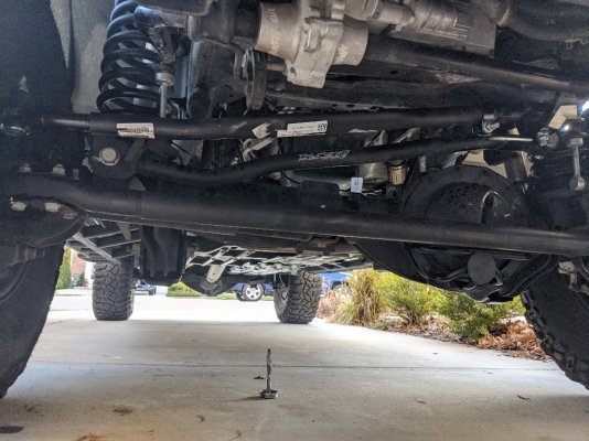

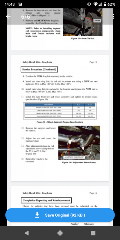

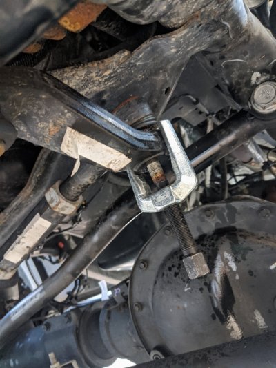

So I can say with absolute certainty that part #68338342AB works on 4th gen 2500s. Install was super simple.I did spray the tapered fits a few hours before with PB blaster, not sure if it made much difference. Definitely get a Pittman arm puller for the Pittman arm side. The knuckle side I smacked good on the knuckle and drag link a few times then used a brass hammer and gave a smack on the bolt on the ball joint and it popped right out. I made a match mark on my Pittman arm for reference so I could get close when adjusting it. I followed the recall bulletin torque values. Torqued the Pittman arm nut to 27ftlbs plus an additional 180° rotation on the nut. This turned out to be about 135ft lbs. Knuckle side was torqued to 44ftlbs plus 105°. This was about 70ftlbs. Coming off this nut was extremely loose I doubt it was more than 25ft lbs.
Broke the locking collar loose and spun adjustment sleeve easily by hand to move the steering wheel to where I needed it. Took it on a drive and had to make further adjusting. After I got it set I match marked the position of everything and torqued the lock collar to 55ftlbs.
ETA: I also made sure my old and new links were close in length before I installed to minimize my needed adjustment
With the adjustments and drives down the road to check the wheel maybe an hour and twenty minutes total. Easy job but definitely invest in the puller!a81440b3e101fbd19bcd375b65b2955f.jpg69e60ab317c074d18e71d158bf7eced3.jpg023edff9cb1106ba14a7f92eced9a3fc.jpgd044a00e6f09d848a2217561164cd439.png

Nice pictures. Much appreciated. Hey what's with your sway bar disconnect? You need to get a junk yard unit or something? I see the grease pen writing all over it. I also noticed that shiny thuren track bar under there too!
To be honest I have no idea, I've never even paid it any mind. I bought the truck used but it only had 1500 miles on it. Had no issues with it disconnects and connects just fine. Yep put that on about 6 months ago or so, need the rear now!

Maybe I should look at mine before I said anything. Maybe mine has writing on it too. Haha
I actually just went and looked at it, can't tell what the first part says but after that it says "ok" ...lol

yeah usually that's like junk yard stuff for scrapped out parts. at least in my neck of the woods but maybe they did that on the assembly line or something. First power wagon I've owned. I don't know anything...…..haha
