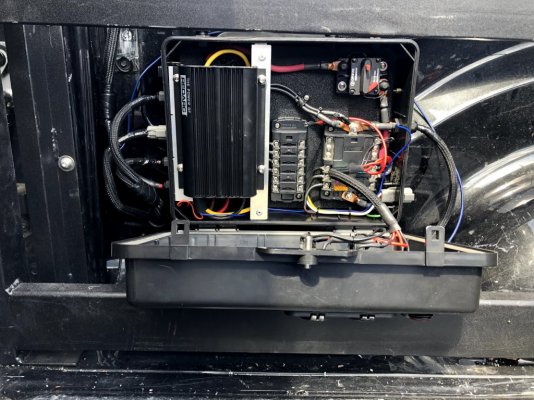

Just check behind anywhere you drill- some areas are closer to the outer skin than others- mostly wheel well area. Aluminum or steel riv nuts are fine- need a better tool for stainless since they are harder. You can over crimp-crush them also- so do some testing before you install them.
The other issue is nothings flat on the inside- i got a cheap waterproof case and put my dc-dc charger and other items for my house(2nd battery) i added.
Just lay out everything you need- they dont make alot of this stuff for rams (what they do is expensive) but if you search toyota tacomas or something you can see everything people have thought up.
