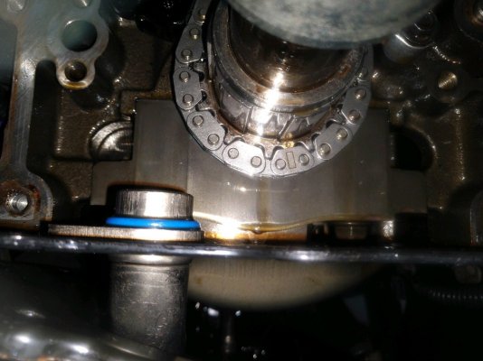

What size is the pickup tube bolt? Looking at some different offset style wrenches.
**** man, I can't believe I gotta undo everything I have worked on for a week...lol this sucks
RamRod37
2014 Ram 2500 HD 5.7 Hemi
Jun 28, 2014
478
510
Georgetown TN
**** man, I can't believe I got to undo everything I have worked on for a week...lol this sucks
10mm or 13mm hard to say it's been over a year since I done mine and good luck with off set hunt its tight and about 1/2 inch + below oil pan gasket circle is thread end of that bolt arrow bolt head not easy to get with out pan dropped. 0219210900.jpg

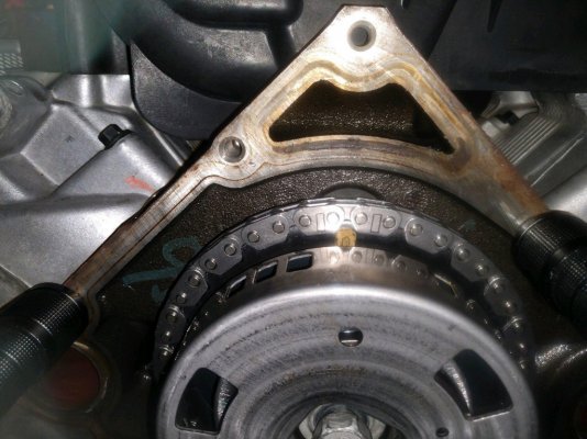

Mine was not quite at 6-oclock on crank.......more like 5:45........all timing components were new........phaser, sprockets, tensioners, & chain
