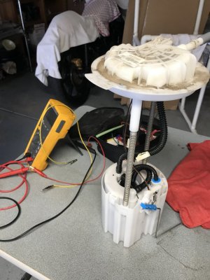

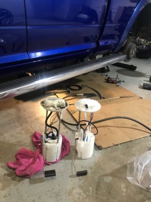

I don’t have a lot of research on the sending units, but the rate of failure from the forums and YT is absurd where people are basically leaving the dealership and the next OEM replacement unit fails.
I bought a Maxfavor $75 entire assembly on amazon. Pump included flows 70-80GPH @ 55-65 psi. Have not found data on the OEM 5.7 unit, if it’s the same as a V6 it flows 60-70 and a ****** is 255LPH.
With an ohm meter on the failed unit, the mechanical sender assembly loses continuity initially(too much horizontal movement) in the middle and continues to grow over time until full/just before empty. The new sender is more robust in that mechanism, but with any aftermarket item time will tell it’s longevity.
