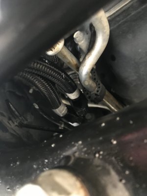

This is what I’ve got installed. It’s the same as the page wild one posted. Transdapt 1127
View attachment 181346 View attachment 181347 View attachment 181348

No leaks are issues with this kit? That’s always been my concern
Mines been on for 3 years ,haven't touched it since the day I installed it.I upgraded the fittings and hoses to 5/8" (-10),and a higher quality hose rated to 3,000psi,overkill on hoses,but they'll also take a ****load of abuse with-out tearing or leaking.I used a combination of these fittings.
http://www.performance-world.com/AN-Fitting-p/809010.htm
http://www.performance-world.com/AN-Fitting-p/804510.htm.
You'll need (4) -10AN to 1/2" NPT adapters if you do something like this.There's fancier fittings,but I had these laying around from another project,and they're easy to work with and don't leak.
http://www.performance-world.com/AN-to-NPT-Adapters-s/1934.htm
