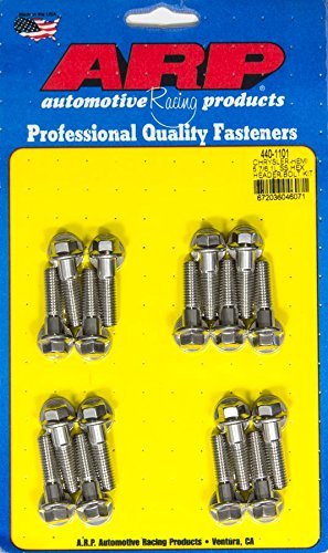

I'll check them but I just put in headers 3 wees ago and replaced all the hardware with ARP header bolts.
so it shouldn't be that... unless ofcourse you didn't torque one or 2 down all the way or it backed out a bit.
