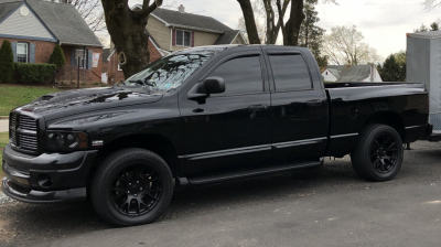

220,000 miles on this 2004 Hemi...... still running extra strong and no Hemi Tick.... THANK YOU View attachment 198089 REDLINE!!!
Yours is a 2004. Grateful that you have not had a problem. However forces have been at work after that and caused an engine change to include cylinder drop off to starve them in order to save gas......
MDS WILL BE TURNED OFF IN MY NEXT VIDEO......
REDLINE! hell yes! That's what im going to from here on out.
What filter do you use bro?
BTW, that is the Dark Knight of trucks!!!

Wix XP 51085XP
While i am here i will also share that i have the factory transmission at 220,000 miles as well and i have never ever changed the fluid or serviced it. I think i may have added a pint or two over the years but no leaks and the pan has never been off the case.
I have a 10 ft dump trailer and a 7X14 ft closed trailer that i tow with my truck for my business and no problems.
