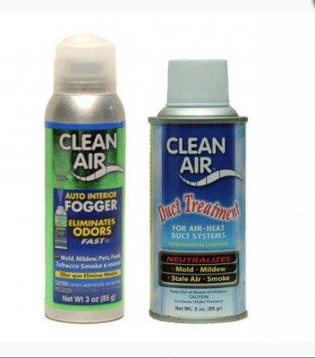

I use a fogger and duct cleaner with great results (German Sheppard dog smell, not smoke). What I would do is have a detail shop clean & shampoo the interior. Then you can use a damp Mr. Clean Magic Eraser on the interior glass. Use the duct cleaner per instructions (spray all duct work and cabin filter area). Lastly use a can of fogger and allow vehicle to sit closed for at least 1/2 day+ for best results. I buy the fogger and use every 6 months on all my vehicles, just the dog SUV gets little more attention.
