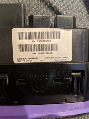

P68397098AE you sure this is the right part number?

Turns out if you drop the P then that is the actual part number 68397098AE.

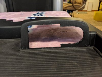

First prototype turned out better than expected. A little tight around the usb ports. Will need to loosen those a bit.

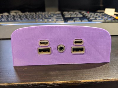

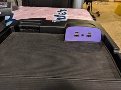

A little progress. While the next one prints trimmed out the opening and tested it out. I'm going to try to get it to either friction fit or clip in so I don't have to glue it but we'll see. also need to create some spots for the hub to clip into the adapter. And obviously some sanding and painting once the adapter is up to my standards.
View attachment 216254 View attachment 216255
Looks awesome. I may have to ask for the 3d file to update my design.

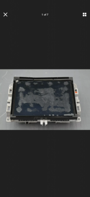

So I found a UAQ on ebay with a busted screen....im looing to buy a new screen for it now..does the slot 1 or 2 make any difference?
Not that I could see. I believe it's just a revised part number and when I ordered an SL02 specifically as a direct replacement I instead received an SL01 and it worked without issues.

sweet....looks like ill have a UAQ unit if all goes well for about $780 total....Looks like the screen won't be too bad to replace

It's fairly simple to replace (a little more involved to remove scratched factory protector). One thing I didn't mention in my original summary was to be mindful of the thermal pads as you disassemble the radio. It's important not to touch them and to keep them free of solvents and or debris. You will find them installed in several different layers/areas throughout the radio.
In short, look at how things set before removing each layer.
I'm curious, what is wrong with the screen it comes with?

Pretty messed up. Seller said it worked as it should before it was pulled out. ebay number 114313776926 if you wanna see the auction 85FC7C02-300B-4C01-BA0F-C8030CF68374.png
