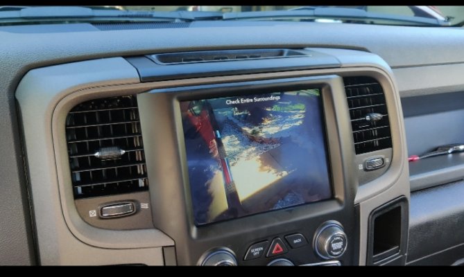

I'm using navtool system with side view cams that will come on the screen with turn signal activation from either side. Soon front cam and then cargo cam 7d131744d41b2f4ca6ed2072b1f18a81.jpg
