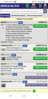

Do you plug the opening with anything for where the fan would go into the water pump?
So you used a 3.7 fan and shroud? What year was the 3.7?
I looked and there was the 3.6 for the same year. The pic is the part numbers for the 3.6 and 2013.
That fan will not work. 2009-2012 v6 fan. 2013 and newer is a different style and will not plug in. It requires a different controller as well. I’m in the process of testing a module that will control that fan assembly.
3.6 E-fan will not work, connectors are different.
No, you don’t need to plug the water pump pulley with anything, you can just leave it alone and it’ll be fine.
Mine was from a 2012 3.7V6. ONLY get the 3.7V6 efan. the 2013+ Pentastar 3.6 Efan will NOT work.
