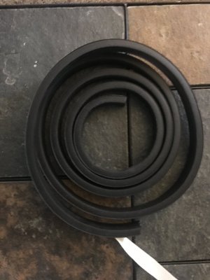

2010
I added door weatherstrip to mine. Can get a cheap roll at an auto parts store. Makes a nice tight seal. Make sure to get the weather strip with 3m tape on one side.
