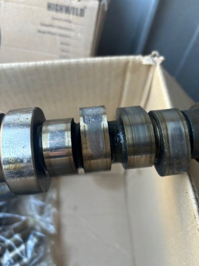

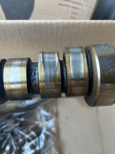

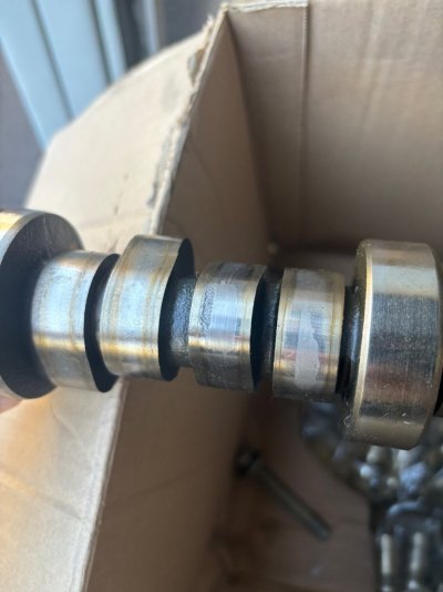

Ok the lifter issue has been my main point of discussion since joining the forum.
I'll grab a pic of the entire cam shortly, but here you can see major pitting and material wear on multiple cam lobes, with one major one.
When I replaced the lifters, one was stuck (corresponding with the worst cam lobe). I later found out the center pin had walked out slightly and was hitting the side of the lifter bore.
video in post #270, pictures of lifter in post #272.
This lifter came out of cylinder 5 (drivers side, 2nd from rear) which is a non MDS cylinder.... part number 53021572AF which i believe is a non MDS lifter (link?)
Everything I've read online regarding cam pitting and spalling has pointed to manufacturing defects in the hardening process.
Hertzian stresses was brought up - "localized stresses that develop as two curved surfaces come in contact and deform slightly under the imposed loads."
Link to youtube lecture on the contact stress subject for any engineering heads who are interested. Cylinder on cylinder would be applicable.
Spitballing and adding pics here, no point being made yet
