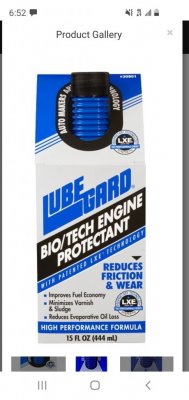

amazon for 6.85 you can try a 10 ounce bottle of biotech, like the thread says, kills a lot of ticks, just dump it in now.

Lubegard is the best moly additive from what ive read here on ram forum. You get oil soluable moly and esters to. Hope your hemi lives a long time! I should add to i got mine with 7k on it from a dealer and ran that oil til 12k and got a free change which i believe they used service pro conventional 5w20. I ran that till 18k befor switching to pennzoil platinum.

EdGs
Nov 29, 2020
5,449
11,565
FL
2015 Ram 1500 SLT QC 5.7L 2WD
113K miles now, had 28.6K on the odo when purchased in Sept. of 2017
Had the startup tick fairly consistent, seemed worse if I would drive to the in-laws house a block away, on restart.
I use Penzoil platinum 5W-20, usually with Fram ultra synthetic filter. Usually go close to OCI on evic display.
Had upper rear manifold studs on both sides broken just under the head of the studs. Were easy to remove, just time-consuming to do.
New hardware, fel-pro gaskets, belt sanded both manifolds best I could, still slight warp-twist on rear cylinder BOTH sides. One month ago.
Added 15 oz. lubegard biotek (first time for ANY addative) with oil change. K&N oil filter (Fram ultra out of stock).
NO tick, and no tick on in-law 1 block run restart. Oil psi is 50-52 cruising hot 215° oil temp, 35 ish at hot idle.
Going to try 5w-30 or at least 50/50 next change.
