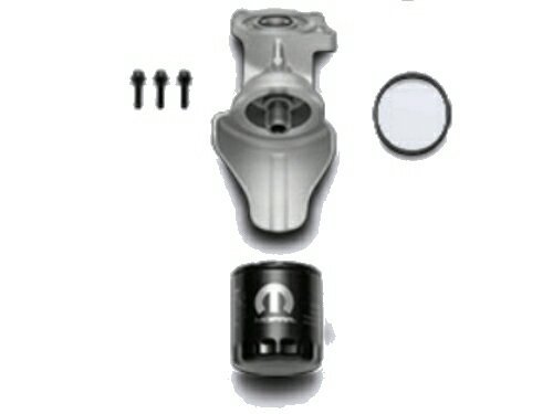

So I came across this part and was very intrigued. I change my own oil and the filter is a pain in the butt to get to. Can anyone give their feedback to this part that currently has it installed?
Part #77072447
https://moparonlineparts.com/mobile/mopar-performance-degree-filter-adapter-p-7350.html
Sent from my STV100-1 using Tapatalk
Edit:
Looking more into this part, it won't fit any Rams. I jumped the gun with this post before I did a bit more digging.

If it moves the filter to sit at a different angle, then it likely would leave your car w/o oil for a little longer at startup.

Depending on how close that drain schroud is to the filter you may be stuck with running the small filter.

Oil filter threads changed in 2010 ish. Odds are this won't even fit your 15. And/or would require an earlier year filter.
Very doubtful, the filter would still be upside down. The fluid won't drain uphill out of the filter so it should be fine. Shame it won't fit the Rams
