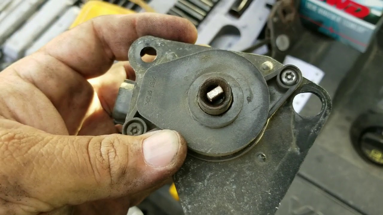

Never done one but it appears like your intake runner is cocked in the bore, I think it is rubber. Did you even touch that? Ignore the misfire code which is cool because most of the time you have a laundry list to check, it is something going on with your runner. When you take it off, my guess you will easily see this. It is kinda a pita, so get more opinions before doing this.

I see there is other possibility then a cocked valve peter, whatever the term is for that thing in the valve that protrudes out. Could also just be clogged. Either clogged or cocked the bad air flow causes the misfire.

I wonder if you can actually bend that thing when doing engine work, probably not, just brainstorming to the why. If you hit it hard or something. Or dirt got in vac, dunno. Couldnbt see one for the hemi, but you see this guys was just stuck.
