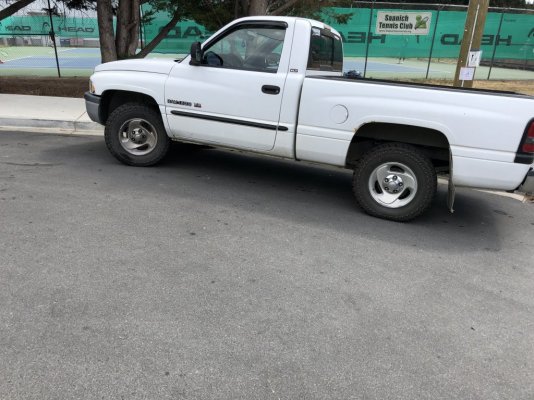

i bought a 2000 laremie slt 5.9 2wd. i should have got a 4x4... i know.

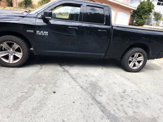

so, i found the same 2014 ram sport rims for sale on fb market, now my 2014 i just bought some new nitta grappler evo's or what ever.
my plan is to buy the fb rims and get a pair of **** rubber on them and put the nittos i got on my 2nnd gen.

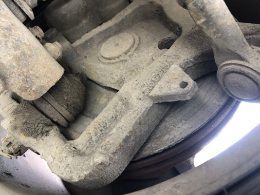

Which front hub do you have?
Is the truck equipped with a one piece front hub or with a unicast rotor that requires bearing, bearing cups (races) and seals?
If you have the one piece hub with a rotor that you can remove then no spacer is required.
If you have a unicast rotor that can only be removed by removing the dust cap, cotter pin and castle nut then you will need a 1.25" spacer in the front.

By one piece hub and rotar I assume your talking about the disk breaks.
the fronts are rotors and the rear are drums.
