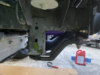

Not just the fact that it’s a filter kit. It allows you to run an oil cooler as well. It is best to run a thermostatic oil cooler though so you don’t over cool the oil. Plus I’m lifted with 35s and harp on my truck constantly and never see oil over 210 even while off-roading which is extra hard on the cooling system since it’s constant load. Also depends on where you mount your filter. Direct airflow helps keep temps lower. Where it’s at now My oil actually stays cooler now than prior than with my stock bumper. And running a larger filter changes my oil temp as well. I run a full 8qts of oil in my truck with this setup. This setup allows you to add an oil cooler as well or run a thermostatic oil filter mount like previously mentioned and tie in an oil cooler that way. It’ll make your life easier. Especially since getting a filter mount to run an oil cooler in the stock location would be a royal pain without running a full filter relocation kit.
