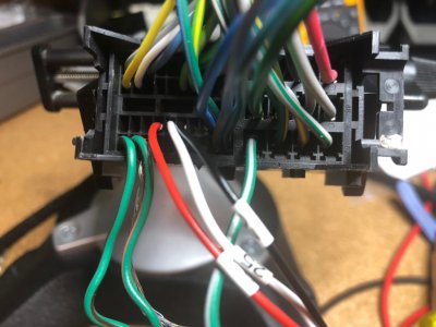

Does anyone know proper Name of the terminal that is used to connect into the radio harness? I want to make my own
thanks.

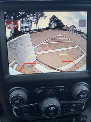

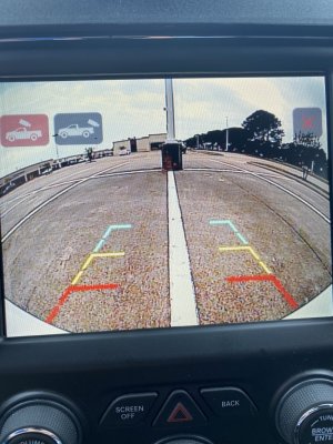

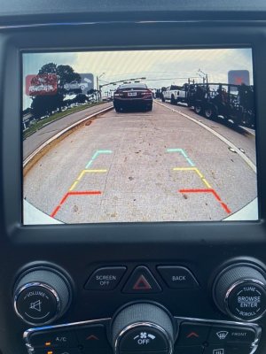

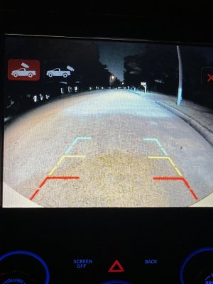

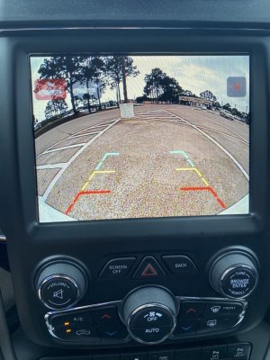

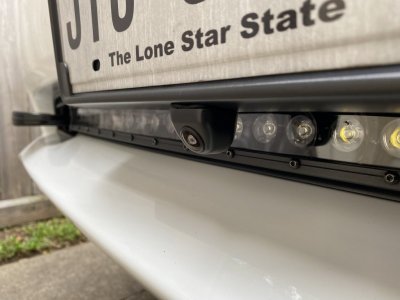

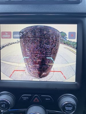

Ok guys, I bought the Nakita WD-011 from Amazon and mounted it under my license plate bracket by drilling one small hole underneath for the cameras mounting stud. I didn’t want to drill into my grille or anything else permanent and this seemed like a good place that’s not even noticeable. The RCA pigtail from @Mpgrimm2 worked great with no issues. The camera viewing angle is good, I can see my white airdam on each side. The clarity during the day is good but kinda grainy at night.
https://www.amazon.com/gp/aw/d/B07H852D49?psc=1&ref=ppx_pop_mob_b_asin_title
The Alfaobd settings are below
VehConfig 1 - CHMSL Camera
"Yes"
CBC Features - LED CHMSL Lamp Present
"Yes"

Thanks, I bought this camera and the coolint flush mounted version to mount in ram head but decided on this location. I kinda like the view looking outward versus downward. The camera itself is very heavy and the housing is metal.

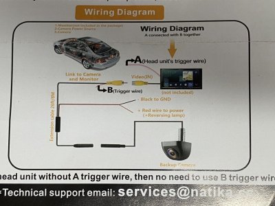

It wasn’t difficult at all. The camera plugs into the included harness. The harness has an rca male on one end and T’s off with black/red for power/ground. All I ran into cab was the male rca which plugs into that harness from Mpgrimm2, then made the settings and boom I got a front camera. I already had AlfaOBD so my total investment on this was approx $70.
