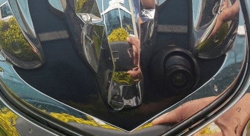

Metra - License Plate Back-Up Camera - Black
Model:BBBPC
SKU:1570003
This backup camera is designed to attach by bolting to the top of the licence plate. I have it installed on the front of my truck in the black filler of the front bumper where it is protected. I purchased it from Best Buy over a year ago. It works great.
