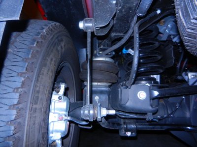

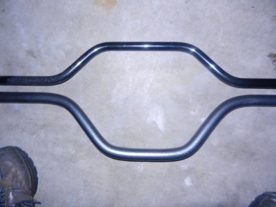

I install one on my 2500 a few days ago I want be towing my 5th wheel until Monday I'm doing a 300 miles trip one way and back again. The Hellwig is bigger for sure I put it on the heaviest setting as you can see that the bottom right is stock on the 2500.

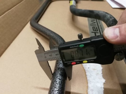

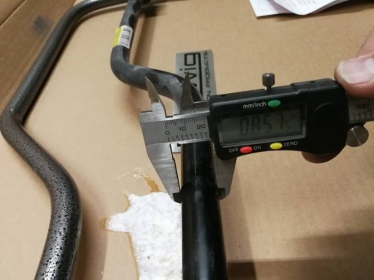

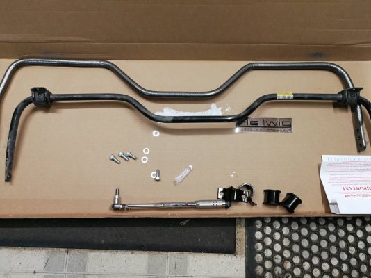

Working on the install now, but here are a couple pics.
No scale, but the Hellwig is easily twice the weight of the stock sway bar, and slightly (approx 1/64) larger as measured.3f27187de12a79f2092eddc74aaeff4a.jpg0c2db980a78bb8322deb2f9787d27ed7.jpg6be61ee4cbb3dd2e0b7a0e4d987b121e.jpg
