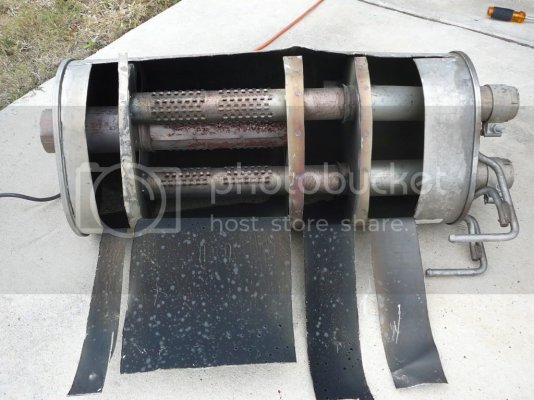

Has anyone cut open a 5 Gen stock muffler?

Purpose of doing this? What are you hoping to see?
pacofortacos
Apr 18, 2017
3,611
4,429
The 6.4 muffler is a little different, in the fact that it has a flapper in it.
But the 5.7 is, I would have to guess, just like every other chambered muffler.
We will await your pics after you cut it open :)

The 5th Gen 5.7s now have a weep holes in both resonators, makes aftermarket mufflers sound like there's a leak. I would absolutely weld it shut or remove the resonators all together.
Otherwise, pretty standard 40" chambered muffler tuned for MDS like the 4th Gens.

Correction, I had to pinch and tack weld a total of 4 weep holes on each resonator for my FIL’s 5 Gen. It helped deepen the tone substantially.
