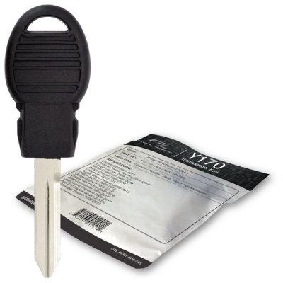

Most of us have the FOB, or more correctly called a Passive keyless entry (RKE) for the Push Button Start Vehicles
Usually there is a Valet key inside the FOB or RKE
What many people don't know, is that you can buy a Transponder Key
It would allow you to unlock your door & start your vehicle
The one for a 2010 Ram
It has a Chip in the head of the key, it cost less than $10 & then whatever your locksmith charges to cut the key & program the chip
2010-dodge-ram-truck-transponder-key-blank-39.jpg 2010-dodge-ram-truck-transponder-key-blank-39.jpg
https://www.carandtruckremotes.com/2010-dodge-ram-ignition-key.html

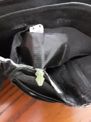

I took a regular key that fits in FOBIK, cut the black plastic part off and gorilla taped it inside my wallet. Now whether anybody thinks this part is foolish or not I took the spare FOBIK and hid that really good inside the truck good luck to them trying to find it. If somebody wants to take your stuff they're going to take it but if I just happen to lose my key somewhere at least I got a way home.
