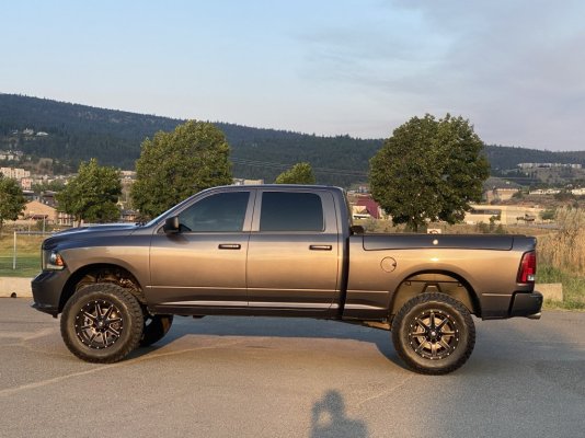

These baby’s.
they fit wonderfully look great too. The welds are superb and don’t require heat wraps or heat shielding. They do have a heat coating.
So far they are perfect. The fit is great and they perform perfect. So much go now it’s nuts. Just washed her up today and I’ll post some photos tomorrow.
I love my truck so much. Cleaning it and looking at it afterwards is so rewarding. Also after getting out when parking. My dad once said if you don’t turn around and admire your truck when getting out of it - it’s not the right truck. I completely agree and I do
So many little things to do tomorrow. Changing the emblem on the tailgate. New deeper amber led turn signal that hopefully closer match the diode dynamics max amber fogs I put on. (Which are AMAZING if you’re in the market for fogs). They are the most expensive fog lights I’ve EVER seen but they’re brighter than my HID and projector headlights by a country mile. Got a rock light thinking of installing, also to try a new UI for my head unit. Then finally tune my stereo and amps. I know there’s so much more to do even small things being busy is rewarding
I’ll get more photos up tomorrow and get pics of the new headers

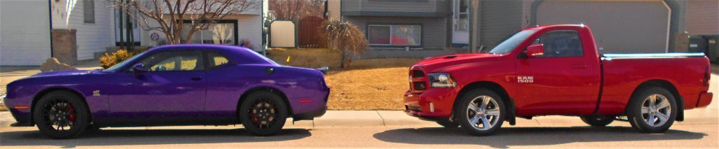

I just sold both of these,but the truck played with Hellcats at the track,and the wifes 6.4 Challenger easily beat up on Hellcats at Rad Torque in Edmonton.
