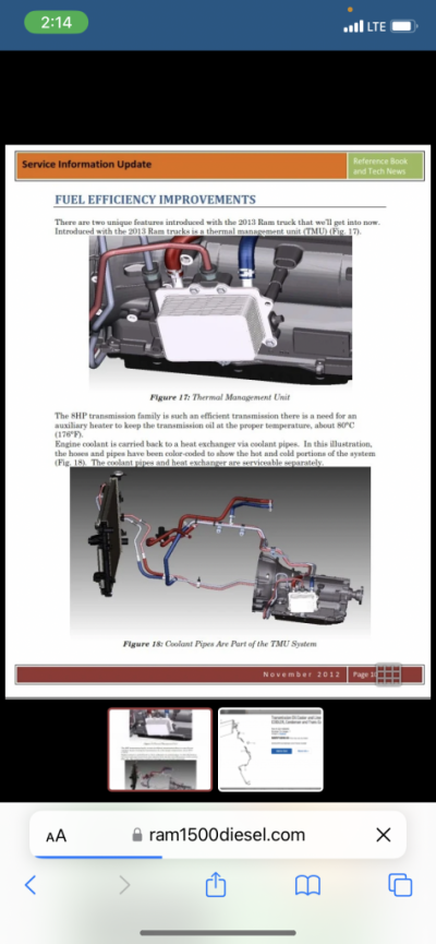

By 2017 V6 ram recently filled transmission with water and I suspect it was from the unit on the side of the transmission that flows coolant to it. Is there a way to by pass or delete this all together so it doesn't happen again?

If the transmission had water in it, most likely from being submerged in/under water. Check the breather tube that comes off the top of the trans if the tube is still in place and not broken.
If ithe transmission TMU was the culprit you would have coolant in the transmission, it should have been distinguishable from water. The TMU would have been replaced.
Usually the only reported problem with the TMU is the thermal bypass acts up and the trans runs hot.
You would need to bypass the coolant piping from the TMU

It would be worth pressure testing the coolant system and finding the leak. You could also just remove the heat exchanger from the TMU and pressure test that. I suppose you could also just remove and loop the coolant lines, if it's leaking you should end up pushing trans fluid out of the heat exchanger.
To do what you're asking, remove the heat exchanger, loop the coolant lines, drill/tap/plug the ports from the TMU-heat exchanger, remove the thermostat in the TMU.
A little work yes, but not expensive really.

Yes a bad cooler can cross contaminate the ATF.
Remove the cooler fill the ATF side with fluid. Pressure test the coolant side. There should be NO bubbles coming up out of the ATF ports. If there is, that's the issue.
I've seen external coolers and internal (inside of radiator) coolers fail.
