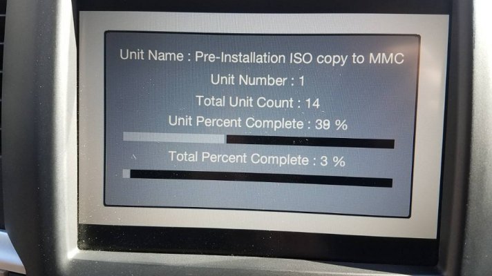

Remember, you will likely see that exact screen several times. If I remember right once you see step/unit 5 you are past what appears to be reboot loops...Good luck![emoji6]
Thanks! Got the update done, backup camera was washed out as expected. Did a factory reset and the backup camera is now not washed out. SXM is working fine and everything else is working fine as far as I can tell. Only hiccup so far is the nav has this message on it. Is this something that will figure itself out if I go for a drive?
