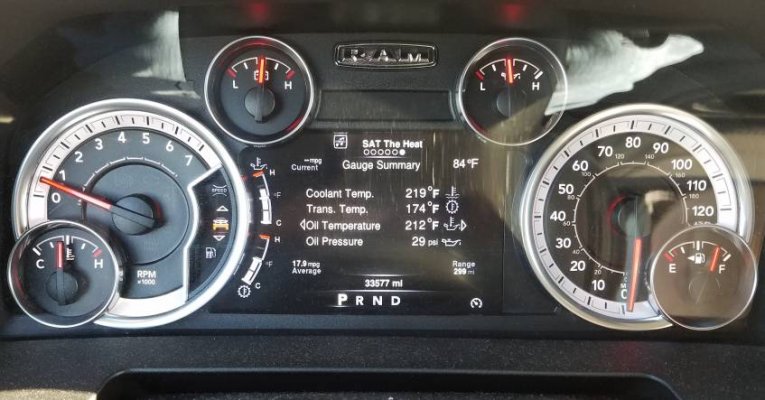

Just as a reference, here's my 2013 v6/8spd CC at 84 degrees outside temp after running around for 20 mins..
Coolant @ 220
