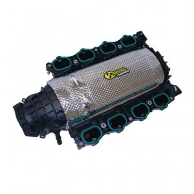

Who cares?
It's not expensive and easy to install, so even if it only helps a little, why not?
Agreed. There are some fairly cheap alternatives out there if one doesn't want to spend $75 on something that may not work. I found a kit thats pretty simular for $20 off ebay. Let yall know how it goes.
LoadedExpressRam
LoadedExpressRam
Jan 8, 2020
624
461
Gulfport, MS
