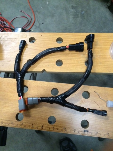

I'll actually go a step further on exterior wiring. I'll get the correct plugs and make pigtails to tap. That way there is NO injury to the OEM wiring. More expensive? More work? Yes to both, but pretty bombproof and it can always be removed with no harm done.

They have solder tubes that you slide over the two wires connected together . Then you heat shrink them which melts the solder over the connection. Super simple and makes a quality snd strong. Connection! I bought 100 off eBay for about 10$

Yea could be an issue I supposed but I have built multiple set of custom lights and wired many of them to connectors or tapped into existing wires and have had zero issues with them 3 years later.
