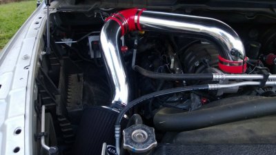

Instead of a catch can you can put a 10$ filter from autozone in the same spot and just change it out every 15,000-20,000 miles instead of check it every 1,000 miles.

Downside to this is you're not using the intake's vacuum to pull vapors out of the crankcase now. Yes you're not building pressure in the crankcase because it's vented to atmosphere but you're also not removing the vapors. Not removing the vapors can reduce the life and condition of your oil, but if you're a guy that swaps it out every 3000 miles then it's not an issue compared to those of us the go for extended drain durations with analysis.

What "filter" could be installed instead of catch can?

If you used a filter instead of a catch can, what kind of filter and what/where are the hoses you connect it to?

Bran. I would like to know also what filter you are using. In-line fuel filter? Wont the oil just plug it up?
