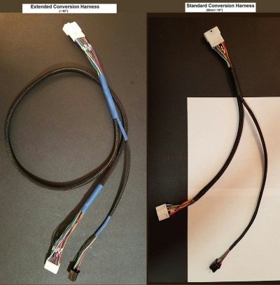

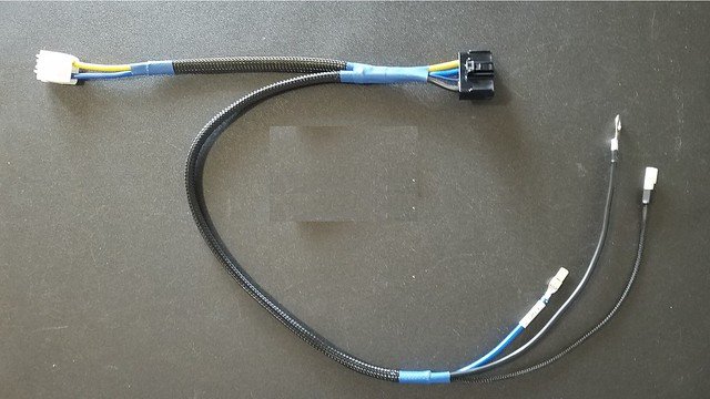

03. Base to 8.4 Radio Conversion Harness (7 speed Fan specific models):
. . See below to make your own in standard or extended length
. . (or get the extended version from: M² Mods )

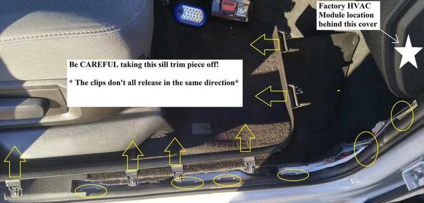

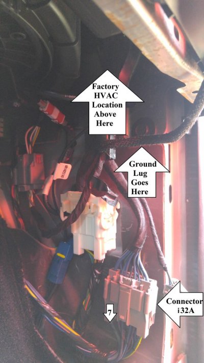

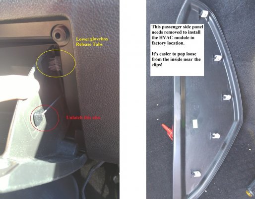

NOTE: See Posts 6 & 7 (from 4spd conversion) for pictures of factory HVAC Module location using extended harness.

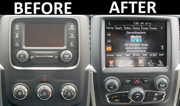

Connectors & Pins to Make Conversion Harness
(Use attached wire diagram and pin-out below)

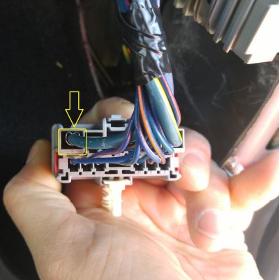

Connector/harness Reference:
- 8 Pin Center Stack HVAC Conn 0307001081 AS-30700-000 Series Instruction Sheet.pdf
- 24 Pin HVAC TEconn 025series Instruction Sheet 411-5928_G4.pdf
- Cptwing's harness making notes at Post 9
- Mpgrimm2 Harness Soldering Notes at Post 13
12. 22 AWG stranded wire
.... (Short harness w/HVAC module behind radio bezel = approx. 18" lengths)
.... (Ext'd harness w/module at factory location behind pass. air vent/glove box = approx. 50" main & 18" 8pin lengths)

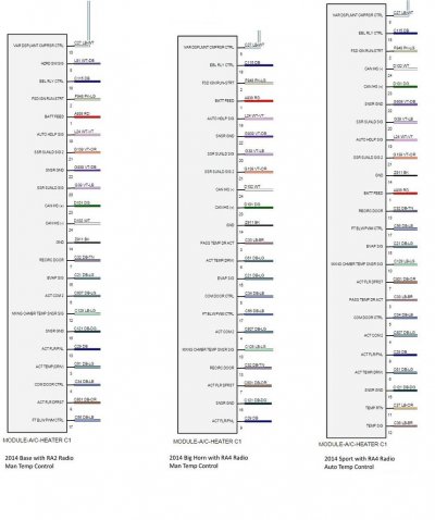

D. Reference for the different HVAC module pinouts per 2014 truck 1500 model:

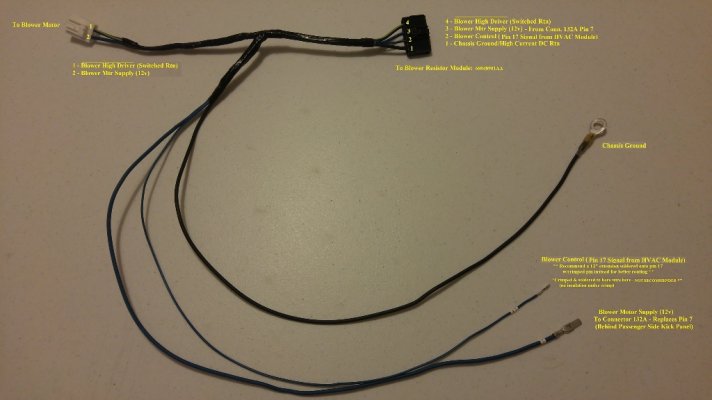

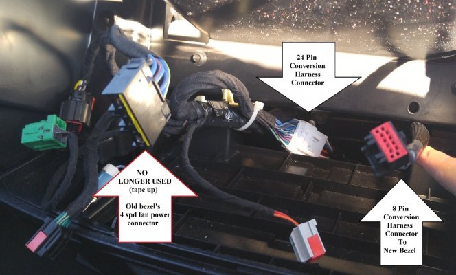

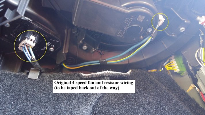

** POST 17 : Important note/Caution about using cheap cloned blower resistors **
Cptwing said:
Cptwing's original post recreated/edited below...
It’s been quite a journey developing this harness along with Getupkid, Duneflyer, Mondo myself and several others. We now have a complete DIY solution for upgrading to the RA4 or RA3 from the RA1 and RA2 radios. The basic Radio is PNP now that we can use the 8.4 bezel and HVAC controls.
There are currently two factory setups for the hvac blower: the 7 speed and the 4 speed.
This is how I understand how the trucks were built, if they were equipped with the RA1 or RA2 radios.
2013 1500's have the 4 speed blower setup. (Fixed Displacement Compressor)
2013-2018 2500/3500's have the 4 speed blower set up. (Fixed Displacement Compressor)
2014-2018 1500's have the 7 speed blower set up (Var. Displacement Compressor)
NOTE:
The conversion for the 7 speed factory fan set up while similar is different and involves not only a different HVAC module but the pinouts for the conversion harness are also slightly different, see Post 2.
Parts Required For MOD:
01. 8.4 Uconnect Radio (VP3/RA3 - Non-Nav) or (VP4/RA4 - Nav)
** For Compatible RA4 Radios see here. **Check car-part.com, Schram, ebay, etc.
02. SINGLE ZONE OEM 8.4" (MTC) BEZEL: 1UJ96DX9AF (AC, AD, AE, etc)
** Optional: DUAL ZONE 8.4" (ATC) BEZEL, while not preferred, will work. See POST 15
03. Base to 8.4 Radio Conversion Harness (4 speed Fan specific):
. . (or get an extended one from: M² Mods )
04. HVAC CONTROL MODULE: 68105017Ax (AA, AB, etc) (4 to 7 speed Fan specific). Replaces 68186216Ax, 68236773Ax, 68268187Ax.
. . ** If you use the wrong/incompatible module (ie xxxx8186Ax = No A/C & 6 vs 7 fan speeds)
< 10/4/19 edit > 2018 2500/3500's w/UAx = 68366553Ax HVAC module. See post 89.
** UAx Radio Upgrade has very high likelyhood of HVAC Blend door issues that are fixed by adding the ATC wiring mod with conversion. See links in UAQ/UAS Upgrade thread. **

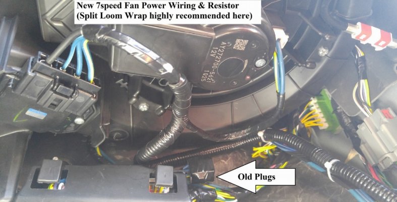

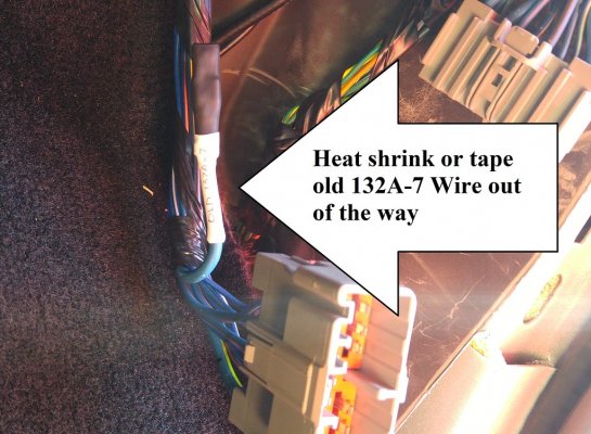

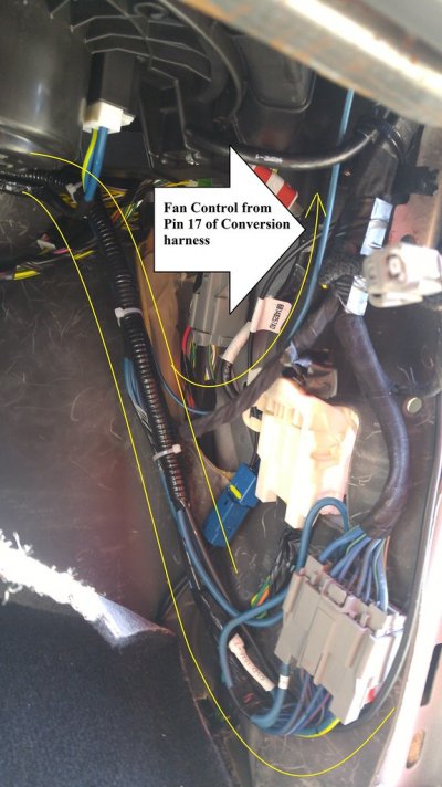

05. Fan Motor Power/Resistor Harness: 68048906AA (Req's Modification)
. . (or see DeereGuy's write-up of 00R/T's notes to make your own at roll-up posts 1765-1766 or get the plug-n-play version at M² Mods ... watch out for poorly made ones elsewhere)

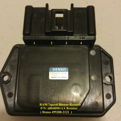

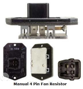

06. 7spd Blower Resistor: 68048901AA (same as Denso PN 499300-2121) See ebay ad and Post 51 )
07. 911 Error Fix/Cell Bypass Plug: (or SharkFin Antenna mod)
. . See note 1 (below) to make your own or get one from M² Mods.
14. Wire 22 gauge 50.0 inches long QTY of 20
15. Wire 22 gauge 18.0 inches long QTY of 5
16. Electrical tape one roll should be enough

The diagram shown below details the conversion harness and pinouts of the various connectors, what is not shown and will be addressed later is how part 1 above ties into it, at pin 17 on the module side.
CptWing RA4 Conversion Harness layout - 4spd w/Mpg2 Edits 4-16-17.jpg
And after a bit of work and eye strain your harness should look something like this...

Next, the item 05. harness (purchased Fan Power/Resistor Harness) will need to be stripped down to retain only the needed parts. Here it is before mods...
(updated picture, thanks JRG18) of the Fan Power Harness (as purchased) with added notes.
In order to prep the bought harness (item 05), we must de-pin connector i32A (mis-ID'd as 132A), to do this you need to remove (release position) the TPA (terminal position assurance) the red thing. Then using a small jewelers screw driver pry back the locking tab and pull out the wire and pin.
Here is the connector and TPA (From later pictures).
Here is the stripped down unpinned harness item 05, this is what you will use the rest will be discarded.
The stripped down Fan Power harness (item 05) connects to the fabbed Conversion Harness (item 03) on the HVAC module side using the DB/LB 16 gauge wire that goes to pin 2 in the resistor plug. I cut this wire to 25.0 inches long and crimped a female pin on it for the 24 pin connector and inserted it into cavity number 17. Note this is a 16 gauge wire and these pins are not designed for wire this thick so you will only be able to crimp the stranded wire into the pin and not the insulation. The other alternative would be to crimp a pin on a smaller 22awg or 24awg wire and solder them together (or butt splice=less reliable).
MPG edit: I think a 12" (i.e. 22Awg) pinned extension for pin 17 would allow better routing of the wire.
Also recommend not shortening the wires.
Next I cut the black ground wire coming out of the resistor plug to 20.0 inches long and crimped a 10 gauge ring connector onto the end and shrunk wrapped the connection.
The DB wire coming out of cavity 3 of the resistor plug is not to be cut. This wire is to be used to re-pin the existing i32A (prev. mis-ID'd as 132A) connector on your truck. I looped the excess wire back and taped it off.
. . (or see DeereGuy's write-up of 00R/T's notes to make your own at roll-up posts 1765-1766 {edit: lost with prior thread delete} or get one ready to go at M² Mods)
Here is a diagram of how the harnesses are interconnected :
Here is the complete, combined and finished harness ready to be installed
MPG NOTE: You may find it easier to connect the fan harness' Pin 17 to the conversion harness after both are 99% installed
(its up to you)

First disconnect the battery, remove the following; center stack (and radio for access), cardboard bottom located under lower glove box, lower glove box and upper glove box cavity (door does not need to be removed), passengers side kick panel and passengers side dashboard end trim piece.
Note: Removing/Installing the radio and bezel are not covered here as there are several places on YouTube/internet that cover it (Separate instruction sheet available in post 3).
Mpgrimm2's panel/prep notes:

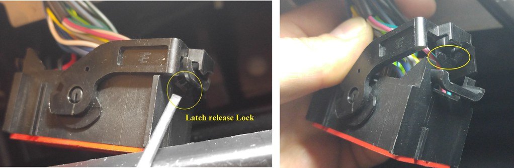

Radio C1 Connector Latch
Once the center stack and RA1/RA2 are removed, you will need to swap out the old bezel/HVAC controls for the RA3/RA4 (8.4A/AN) bezel. Set this aside until later.
8.4 Bezel Back2
Lower Glovebox release and HVAC Module Passenger Side dash cover
Glovebox & Side Panel
Passenger Side Kick Panel/Door Sill (PAY ATTENTION)

Now to install the harness we have to first replace the existing resistor with the new one (part 3), remove the 2 phillips head screws securing the existing one and replace it with the new one using the existing screws.
Here is the existing resistor prior to removal
And here are the two resistors...

Now to install the harness:

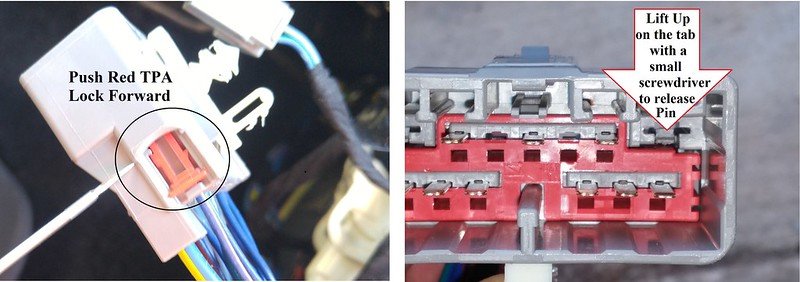

Unplug the existing connector from the motor and tape it off along with the existing resistor plug they will not be used. Then unplug connector i32A (prev. mis-ID'd as 132A) and replace the wire located in cavity 7 with the one in the new harness, this is the 10 gauge wire you unpinned from part 1.
Reference Locations:
20160102_122948
Connector i32A Before:
Backside view of i32A-7:
Connector i32A - TPA lock and Pin7 Release point:

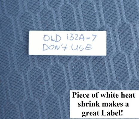

Connector i32A with pin 7 wire removed
Heat shrink label
Old i32A-7 taped out of way:
Here is connector i32A after I switched the wire in cavity 7
Attach black 10 gauge ground wire ring terminal to body bolt location as indicated earlier.
Plug new harness into resistor and motor.
Here is the new fan harness and upgraded resistor to enable 7 speeds.
(NOTE: The split wire loom will protect the wires from damage by nearby bolt/threads)
Plug harness into module and begin routing it to radio bezel along the same route as the existing body harness and SDAR / Cell antenna leads. The new harness is shown wrapped in corrugated split loom.
Another view as routed, looking through the upper glove box.:

Finish routing the harness into the center stack area and plug the 24 pin connector on the harness into the existing 24 pin connector on the truck. Plug in the connectors you previously unplugged and also plug in the 8 pin plug into you new bezel.
Harness coming in behind bezel:
Reconnect battery and test everything and ensure it is working correctly. Reassemble your truck
And here is the bezel installed while testing harness showing all 7 fan speeds, yes that's right the fan now has seven speeds it seems to push more air and is quieter.
And here is the finished job! Everything on the bezel works as it should. Works perfectly!
Oh and prior to bundling it up I tried two other bezels I had. Both are dual zone with auto climate control. They also worked except for the actual dual zone or auto climate control functions. The drivers side temp switches were active to control the temp, but the passengers side temp buttons did nothing. Otherwise they were fully functional. Just something to think about if you already have an auto climate control bezel and do not want to buy another one. SEE HERE.
Enjoy

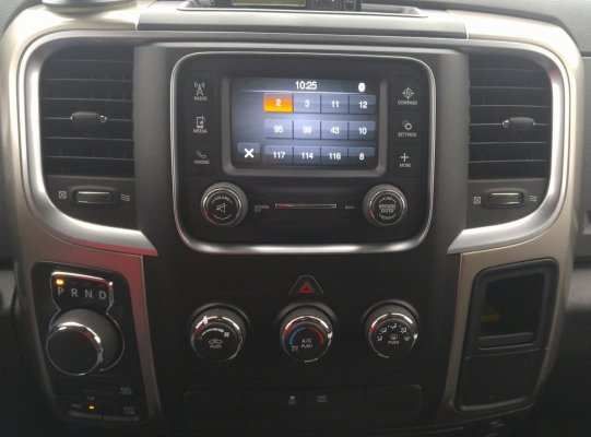

Here is a before shot with OEM bezel (Radio Testing)

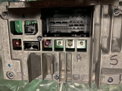

Reference for the 8.4 Radio Connectors
Heres an update on my install. 2 colored fakra connectors missing but fixed it with some fakra to smb adapter. So far its working good.
Here's links to some of the adapters if needed: (disassemble the plastic housing off the female end)...
Curry Fakra K (SXM) - eBay
Curry Fakra K wRt Angle (SXM) - Amazon
... $11 on eBay (6" by RfBat, long lead time)
White Fakra B (FM) - eBay
... $13 on eBay (long lead time from China)
... $11 on eBay (not sure on length, 4"-12"?)
Bordeaux 'Prpl' Fakra D w/Rt Angle (Cellular) - Amazon (by EightWood .. N/A)
... $12 on ebay (4"/10cm by RfBat, long lead time)
Universal Fakra Z w/Rt Angle - ebay

Mpgrimm2’s - Some soldering basics to start:
Soldering pt 1
Soldering pt 2
Soldering pt 3
Soldering pt 4
Questionable Solder Splice
Crimped & Soldered Pins (Optional - Unless crimps are questionable)

Post 14:
More Mpgrimm2 Extended Harness "Braided Sleeving" notes:
NOTE: I used braided nylon sleeving and heatshrink which can be a bit more difficult to work with vs split wire loom.
(i.e. I covered harness with 1/2' nylon sleeve/braiding. Finished with 3/4" & 1/2" heatshrink.)
Other End 1:
Other End 2:
Other End 3:
Other End 4:
Other End 5:
Finished Harness w/Sleeving:

Post 15:
Just a quick note on the bezel ...
There are 2 bezels that will work with the 8.4AN conversion...
- Preferred option 1:
P/N: 1UJ96DX9AC or 5VD75JXPAA (or AE, AF, etc)
- Workable option 2:
DUAL ZONE OEM 8.4" (ATC) BEZEL
P/N: 1UJ97DX9AC or 5VD73JXPAC (or AE, AF, etc)
Indaram's - DIY - OEM 5.0 Radio to 8.4 Radio Upgrade
Cptwing said:
Yes the dual auto climate bezels will work, but will function as single zone manual climate control. The ATC bezel has all the same controls/buttons but also has 3 extra buttons that will be non-functional with the basic 8.4 upgrade/HVAC conversion; ie the 2 right side buttons (up/dwn) for the passenger side Temp control (dual zone), and 1 (1/2) button on the center knob for the Auto temperature feature.
Only the driver’s side temp button will function and the auto function will not work. But besides that it will function the same way.
The ATC bezel was verified to work minus the items noted above by Cptwing, Jared4.7, See Here, (and later by Mpgrimm2).
Jan 11, 2016
EDIT:
You can now enable/add Single Zone ATC (still no dual zone!)
- How to Add (ATC) to a Manual Temperature Control Truck
& it's possible to combine both bezels for a Single Zone ATC Bezel, see post 8 of ATC Thread.
EDIT 2:
If you really want to pursue true dual Zone ATC, it's possible but very involved.
Adding dual zone atc to a tradesman.

A heads up about using cheap Chinese clone blower motor/fan resistors....
IMO... You're better off getting a used OEM one vs a new clones version.
.just troubleshoot a similar situation and it turned out that a genuine resistor fixed the issue. Here's video of the issue with clone resistor vs OEM resistor
Updated video Link: https://youtu.be/STwZpe4pns4
Vs.
OEM resistor...Updated Video Link: https://youtu.be/2cfE0LAM_Ps
Thanks for posting. The fact that you bought a kit and can't get people to respond back when you have an issue after several days and had to contact me, is well ...
Let's see a picture of the resistor itself ie the face of it... I can tell if it's one of the Chinese clones vs Mopar/denso. I've seen reports from people claiming these work fine and I bet the clone is what you've got.
You don't even have to take it out. Here's a picture of a $100 genuine resistor vs $20 clone. (I've also see a clone resistor that looks nearly identical, and has issues. Probably used the original molds)
OEM...
Clone...
OEM fan resistor values here as a reference...
