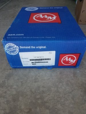

For the gear change are you having to use a ring spacer for the front and pinion conversion bearings for the rear? Getting ready to do my gear swap and doing all my research.
my front just showed up. picked up the rear and most of the other necesarry parts a while ago. hope to get everything installed before to long but who knows with the current world situation. what i now know is my truck and wyram truck and likely every gen4 wagon with elec cad has factory installed 1/4" spacer so no addition parts are needed in the front. just gearset, ring gear bolts, crush sleeve, some bearings and seals could be reused if you so desire or go all new. im most likely going to replace everything in there just so its all fresh at the same time

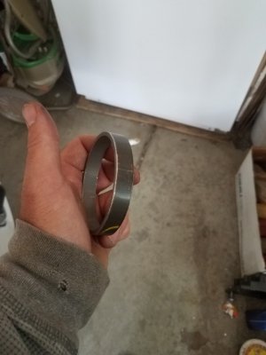

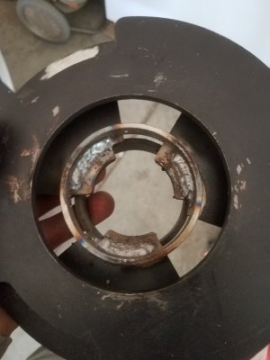

heres a tip for using the traxda 1" rear spacer. traxda sort of dropped the ball and overlooked something i feel is important. once the spacer is installed ontop of the top rubber isolator, theres now nothing to hold the spring assembly concentric to the frame tower . what i did was get a piece 3"×2.75" 1/8 wall dom tube and cut small pieces about 13mm or 1/2" iirc. then weld it into the center of the spacer. now the top frame tower slides into the welded in tube and holds the spring centered
