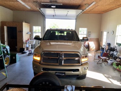

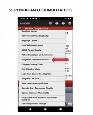

Using AlfaOBD, I’d like to add DRL’s to my truck, utilizing my turn signal running lamps. I followed the directions listed in Google Drive, but hit a stumbling block. The instructions state to select “Program Customer Features” as the procedure. Problem is, I don’t have that procedure listed when I get to that step in the app.
I don’t know if it makes a difference, but I have factory projection headlamps with LED turn signals/running lamps.

If I remember right I think that step adds the ability to turn drl's off through the radio. You can just skip it

Use the parameter settings found in the known working list in the first post of the AlfaOBD thread:
https://www.ramforum.com/threads/alfaobd.123982/
from the list:
DRLs: (Daytime Running Lights) For “Dedicated” DRLs (Rams with factory projectors) see post #7079
https://www.ramforum.com/posts/2032174/
CBC Features: DRL Configuration
Select “Optional DRL”
CBC Features: DRL Lamp location (several to choose from, high beam, low beam, fog lamp, dedicated and SRT Light Bar) Known working high beam, low beam, turn signal and fog lamp.
CBC Features: DRL Dropout Enabled
Select “yes”
ECU 3: DRL Customer Setting Enable/Disable
Select “yes”
Customer Service Menus: Daytime Running Lights CSM
Select “yes”
All of the above settings are under the Body Control configuration.
Don't use DRL drop out if your using the High or Low beams as DRLs.
