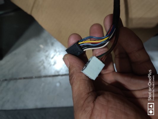

I have a 2019 1500 classic if i installed power folding mirrors can i set them to closed when i turn truck off? Do i need anything else other than the power mirrors for installation?

No. The auto fold option doesn't work when set in the BCM which is most likely because it was never an option on a Ram pickup. I think some members have been working with the developer to see if he can get it to work. In order for them to work you will need to install the correct door modules and switch. If you currently have power adjust mirrors then you will have all the necessary wiring and enable the power fold option in the BCM with alfa tool.
Know the part number for the modules? I search web but gives me diff module part numbers.

Sorry didn't notice your post. The door modules I used are 68225102AC Right side 68225103AC Left side. I reccomend contacting Benny @AllMoparParts.com in the vendor section on the forum to double check your part numbers and order them. They have great prices and he is familiar with most of the upgrades we do.
