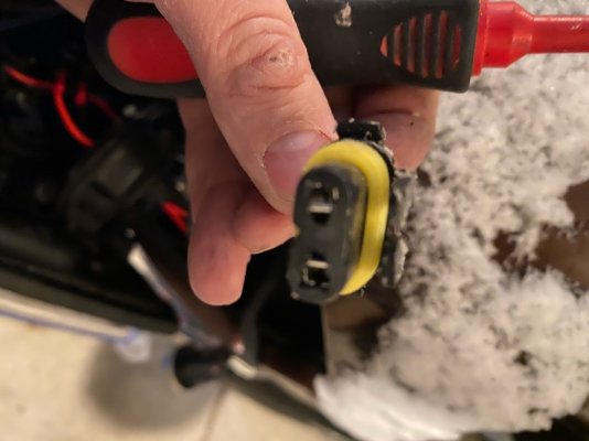

Ok I found the issue , in tracing the wiring found a black wire that was pulled down in the connector housing just enough to not get a good connection
Pushed tight and taped ends . Flickered first a minute when started truck but seems to have stabilized . Hopefully will last but have the other hid coming as a backup . Thanks for all the help
