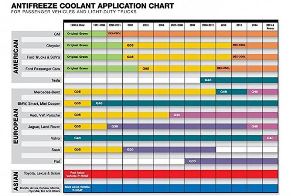

what do you use for coolant?
Thining of doing mine this Spring.
I know mine takes HOAT, I believe yours takes Oat, if I were you I would use nothing but Chrysler 10 year oat, it's purple when cold. If it says anything but 10 year, it's not for your truck. Coolants don't mix well, this chart is just to show when they changed, I surely don't recommend dex, it is a different type of oat coolant. Only use Chrysler oat 10 year imo. I'll check your owners manual to double check.

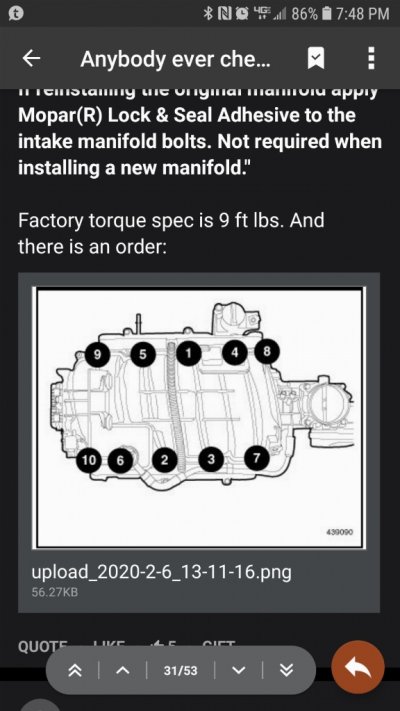

Not sure this makes sense to me, unless a new manifold automatically comes with new bolts:
"NOTE:
If reinstalling the original manifold apply Mopar(R) Lock & Seal Adhesive to the intake manifold bolts. Not required when installing a new manifold."
Factory torque spec is 9 ft lbs. And there is an order:
New bolts probably come with loctite on the threads thats all. The new age of master techs can't even apply there own loctite lol or god forbid the PCM/ECM/OBD2 couldn't tell them what the problem was they would prob never figure it out.

R.L.K.
Dec 1, 2013
12,803
12,508
Bristol , Tn.
Checked mine tonight after i let the engine cool for 2 hours with the hood up ...38° f in my shop .
I used the pattern in the picture ....starting at 40 in lbs
@ 40 " lbs no movement
@ 60" lbs slight movement on number 8 &10
@ 80" lbs movement on ALL
@ 95 " lbs all moved again as expected
at this point i torqued all of them in the pattern in the picture to max tq. of 108 inch pounds 3 ea times till all the torques stabilized .
