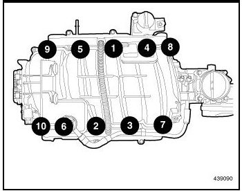

Not sure this makes sense to me, unless a new manifold automatically comes with new bolts:
"NOTE:
If reinstalling the original manifold apply Mopar(R) Lock & Seal Adhesive to the intake manifold bolts. Not required when installing a new manifold."
Factory torque spec is 9 ft lbs. And there is an order:
"NOTE:
Hey....same picture I use.....[emoji106]
"NOTE:
New manifold comes with new bolts with Loctite already on them
