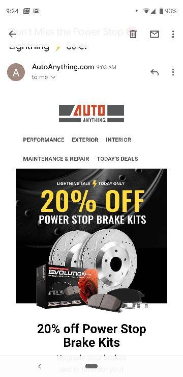

Just got this email from Autoanything on Power Stop brakes. I've never tried them but have been seeing them mentioned often. I haven't priced them but think they should be a good quality, cost effective solution. e4ad1646598654d62637677f1bea7492.jpg
