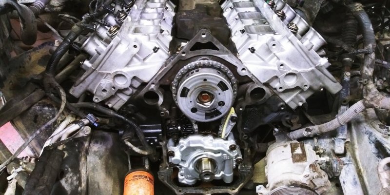

Been there done that the A/C compressor uses three studs to mount it one in block and two in timing cover the two in front will have to be removed but just take the nut off back one and let Compressor rest as seen in my picture also It may be easier to remove inner fenders it helped with Exhaust manifold to Pipe Bolts and do not worry about trying to remove manifolds from head in truck leave em on there just remove the two from pipe pull heads and manifold as one unit
This is great info, thank you!
