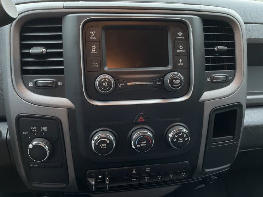

I'm starting to gather all of the items needed to upgrade my 2018 3500 Tradesman 5.0 radio to the UAQ NAV radio. I ordered a used bezel with the one zone HVAC but have a question in regards to volume control. Is there a harness to buy that allows the volume control button to work once you upgrade? I don't have the steering controls and that looks like a huge PITA to install. It looks like Infotainment has a harness to get it working but I know they are way overpriced. Thanks for the help.

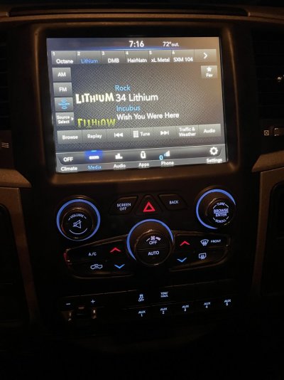

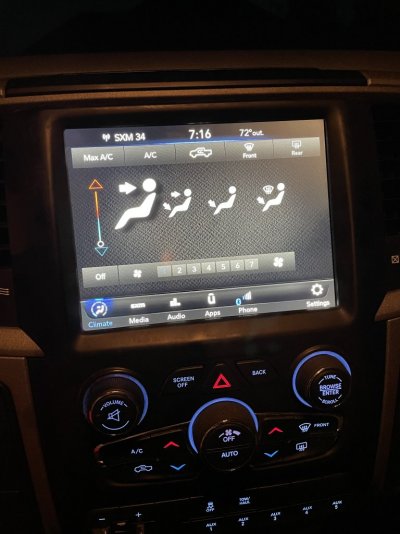

Just finished up a 5.0 to 8.4 upgrade on my 2018 3500 tradesman and everything is great. @Mpgrimm2 hooked me up with all the harnesses I needed and troubleshot an issue I had with a janky bezel. I’m lucky that I don’t have the HVAC issue but will probably flash the ATC module in the future.
Highly recommend this upgrade.
