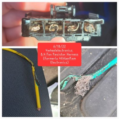

... Another one of "4th Gen Ram's" customers (edit: now going by 4wheelelectronics ) that found me via Facebook referral. I will be getting him fixed up because of a crap harness that apparently looked ok when installed ... (He gave permission to share).
It's the worst one I've ever seen (there have been several) ... it sucks to see people have to pay more money to fix poor quality like this.
8/1/21 Edit: similar no support situation ...
View attachment 467261View attachment 467262

Any of you that got your 8.4 4 speed conversion harness set from somewhere else ... Check your fan resistor harness!
Here's someone else's customer that just came to me with a bad fan harness ....

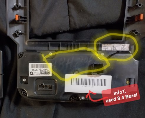

Tonight while helping a customer that got something else from me, I learned that InfoTainment is selling 8.4 13-18/classic 8.4 Conversion harness kits (w/o radio) with USED/Refurbished 8.4 Bezels... Not new ones & not specifying this anywhere.
(Also taking Dual Zone ATC bezels and Vinyl wrapping over the pass. side temp controls and shipping w/kits vs Single Zone MTC bezels... Not stated either. Customer got a used 2015 Dual Zone ATC bezel with their kit). Might be why the price people that are getting their own used 8.4 bezels went up.
This is separate from selling "refurbished/tested" radios which is generally understood & indicated.

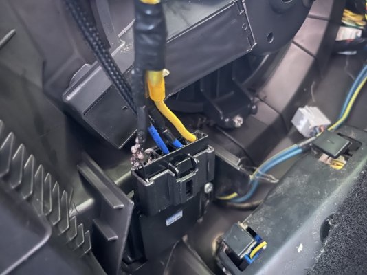

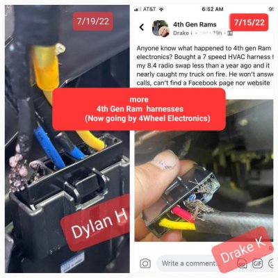

This is part of the harness from 4th gen electronics..found out that I wasn’t the only one with this problem..mike over a m2mods was super helpful and got me hooked up asap with a better harness
There was another one just before you over in the Facebook group also...
People with 4speed 8.4 conversions from them really need to keep an eye on that fan harness...

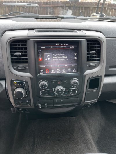

Thank you again Mpgrimm2 for the conversion harness and HVAC module. It was a very easy install. Took me only about 30 mins to do the full install with radio and bezel swap. And everything works perfect! Been installed for about 2 months now
