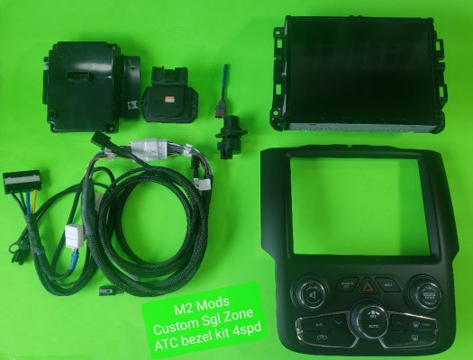

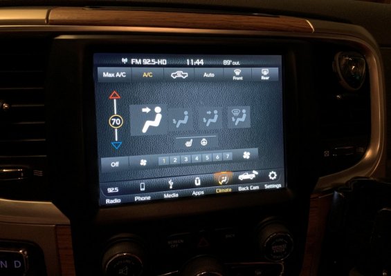

I have a complete 2017 RA4 VP4-NA Upgrade kit with SINGLE ZONE ATC hardware option and Includes custom Single Zone ATC bezel...
** This is not an Android Auto Apple Carplay radio**.
(extra sensor Included for 4 speed 2500/3500, ATC wiring is already built in to the harness. 1500 req's an extra harness and sensor for a bit more). Ideally for a 2013-17 ram but can be used in a 2018/classic truck, but will have cell error service message that can be fixed with a work around.
Comes with used/tested 17ra4 w/unlock code & sw v18.45.x (very good condition), custom Single Zone ATC bezel, cell bypass plug, new HVAC module, our universal conversion harness with ATC (& New Mopar/ Denso fan Resistor & Plug n play fan harness for 2500/3500's).... & I can swap out parts for 1500 ATC harness setup.
17ra4 Nav radio & custom Single Zone ATC kit for 2013 -17 4spd 2500/3500 trucks
- 17 RA4 VP4-NA nav radio 68260661Ax with unlock code and sw version 18.45.01
- Custom 8.4 Single Zone ATC Bezel (see here.)
- 4/7 spd Universal Conversion harness w/ATC Pt1 v4
- 4 to 7 Speed Fan MTR Power harness v4 (plug n play)
- Cell Error Bypass Plug
- Mopar/Denso Fan Resistor and HVAC module for 2500/3500’s with RAx radio - New
- ATC Cabin Temp Sensor - New
Message me if interested. SOLD shipped/USA.
(Can also split up the kit if you have your own radio, ie UAQ or UAS that requires Single Zone ATC to work correctly, or can offer a new Single Zone MTC Bezel without the ATC sensor for $150 less. You can still add ATC later).
M² Mods.

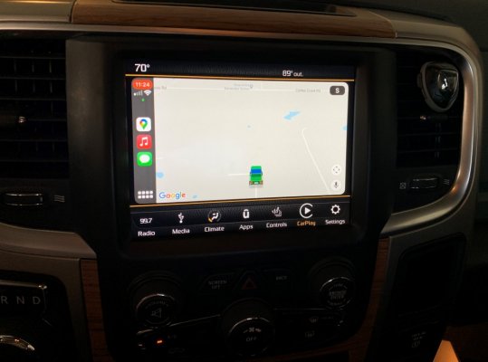

Finally got it all working- 2018 8.4" UAS radio with Apple Carplay & Single Zone ATC. Time for a Pee Pee dance!
(Thanks VERY much to @Mpgrimm2 for his help)
