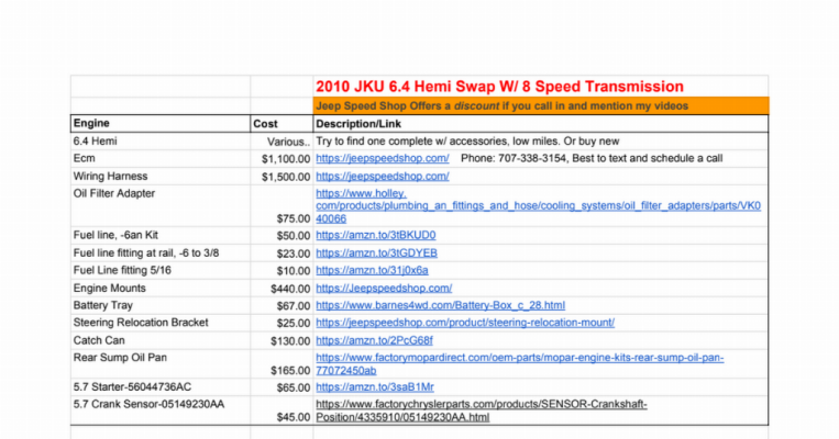

This is a cost breakdown of a guying doing it himself in a Jeep,using alot of used parts.Even using alot of used parts he was still into the swap for well over $15,000 and this was going on 5 years ago,and prices have increased substantially since then.
2010 JKU 6.4 Hemi Swap W/ 8 Speed Transmission
Jeep Speed Shop Offers a discount if you call in and mention my videos
EngineCostDescription/Link
6.4 HemiVarious..Try to find one complete w/ accessories, low miles. Or buy new
Ecm$1,100.00https://jeepspeedshop.com/ Phone: 707-338-3154, Best to text and schedule a call
Wiring Harness$1,500.00https://jeepspeedshop.com/
Oil Filter Adapter$75.00https://www.holley.com/products/plu...ng_systems/oil_filter_adapters/parts/VK040066
Fuel line, -6an Kit$50.00https://amzn.to/3tBKUD0
Fuel line fitting at rail, -6 to 3/8$23.00https://amzn.to/3tGDYEB
Fuel Line fitting 5/16$10.00https://amzn.to/31j0x6a
Engine Mounts$440.00https://Jeepspeedshop.com/
Battery Tray$67.00https://www.barnes4wd.com/Battery-Box_c_28.html
Steering Relocation Bracket$25.00https://jeepspeedshop.com/product/steering-relocation-mount/
Catch Can$130.00https://amzn.to/2PcG68f
Rear Sump Oil Pan$165.00https://www.factorymopardirect.com/oem-parts/mopar-engine-kits-rear-sump-oil-pan-77072450ab
5.7 Starter-56044736AC$65.00https://amzn.to/3saB1Mr
5.7 Crank Sensor-05149230AA$45.00https://www.factorychryslerparts.com/products/SENSOR-Crankshaft-Position/4335910/05149230AA.html
TransmissionCostDescription/Link
8hp70 8 Speed$800.00I found mine on ebay with 30K miles, New: $3,200- Mopar R8273231AA (Verify with dealer that it fits 13-17 Ram 1500 w/ 5.7 and has 4x4 trans adapter.
Challenger Shifter$150.00Ebay
Intermediate Structural Cover$50.0053021491AA
"Dust cover"-52104344aa$23.00https://amzn.to/3c9kBya This is what goes between Eng and Trans
Tap for Cooler fittings$26.00https://amzn.to/3s8zUN3
Cooler Lines- 68291875ab$200.00Dealership or Online
8 Speed Kit$1,500.00JSS
Ram Trans mount$58.00https://amzn.to/3uj2Dzu
Plate B$40.00JSS
Gladiator Pan- 68408606ab$94.00Dealership
CoolingCostDescription/Link
Radiator (2 Options)$900.00https://jeepspeedshop.com/product/radiator-for-2007-2018-lx-and-dr/
Hoses$25.00https://www.ebay.com/itm/Gplus-For-...496294?hash=item41fe6e00e6:g:0MQAAOSwpWRcpruR
Overflow Bottle$7.43https://amzn.to/3rjRc8M
Camaro Fan-84100128$250.00Ebay, Rock Auto, or junkyard
Camaro Fan Shroud$450.00JSS
Fan Controller$200.00JSS
JSS AC Lines$400.00JSS
Power Steering Cooler$225.00https://amzn.to/392Pfra
Trans Cooler$285.00https://amzn.to/3r8HjL1
Electric Fan Sensor$12.00https://amzn.to/3vPK8V5
FluidsCostDescription/Link
Engine Oil$66.00https://amzn.to/3tJ3RUi
Trans Fluid$126.00https://amzn.to/3c7RmvR
Coolant-HOAT & Distilled Water$21.00https://amzn.to/2QssMNL
Power Steering Fluid$10.00https://amzn.to/3c7eoCU
Exhuast and IntakeCostDescription/Link
Manifold Left- 53013857AD$170.00https://amzn.to/3s9PsAl
Manifold Right- 53013858ad$160.00https://amzn.to/3s8Dnvd
Manifold Gaskets$25.00https://amzn.to/3vLz8rJ
Heat Shield x2$32.00https://amzn.to/311e6ai
Manifold Bolts$40.00https://amzn.to/3941bZx
3" Tubing kit$158.00https://amzn.to/2Qr03bZ
2.5" Tubing kit$136.00https://amzn.to/31gKSEI
Y pipe$26.00https://amzn.to/3vNscKE
****** Muffler$90.00https://amzn.to/393zTCA
Resonator$42.00https://amzn.to/3f1kYg4
02 Sensors x4$168.00https://amzn.to/3f2UDyo
Hangers$20.00https://amzn.to/3lLK6cb https://amzn.to/3rlzK3E
V Band Clamps$35.00https://amzn.to/2NQ31pH
Catalytic Converters$180.00https://amzn.to/311fpWK
02 Sensor Bungs$28.00https://amzn.to/3c7QN57
Intake Pipe$57.00https://amzn.to/2OTTjmG
Intake Elbows$7.00https://amzn.to/3cUVBd9
Filter$40.00https://amzn.to/3c8g9Qo
My Cost$15,549.00
